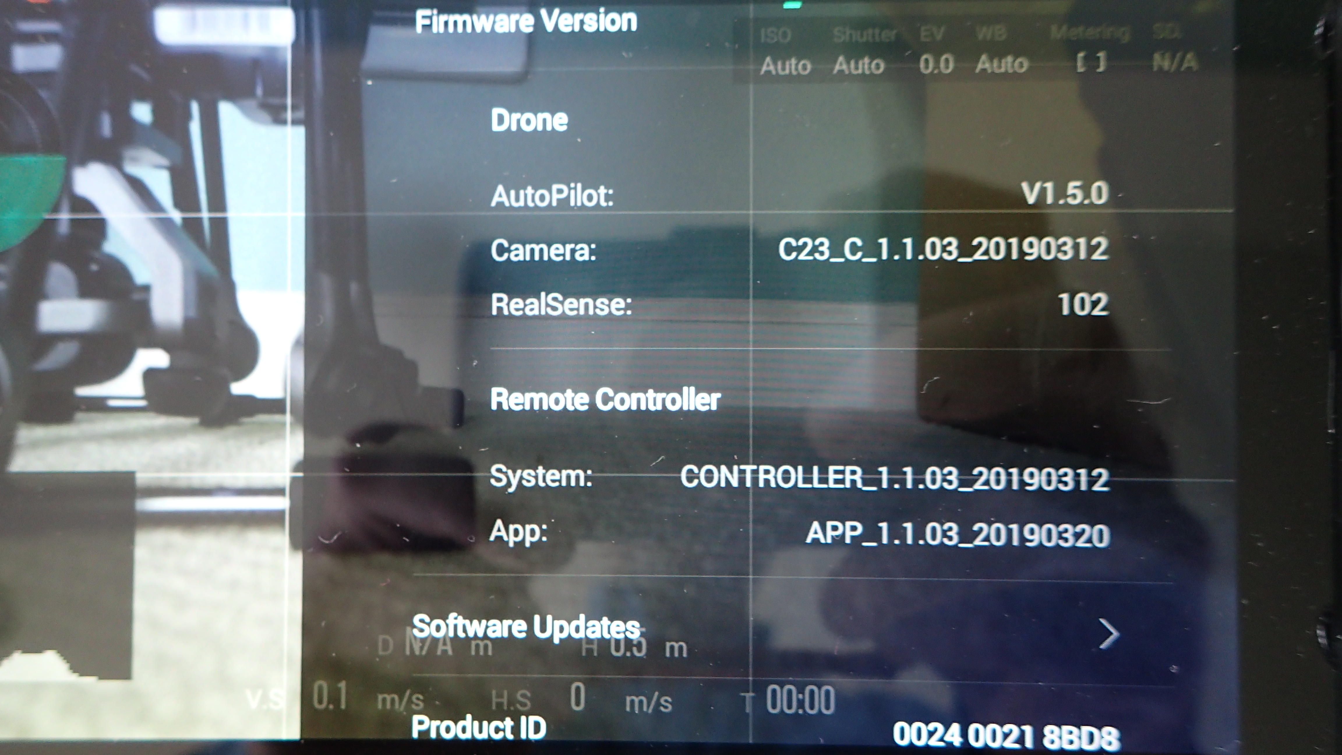

    Screen Print from my iPhone today showing various Software Versions.
    I'm having similar Wi-Fi issues. I've been flying very conservatively since this "upgrade" but the Breeze consistently loses my Wi-Fi signal at around 15-20 meters. Video freezes, controls don't function (FPV Controller or App Based) so I intentionally have to go into my Wi-Fi to manually disconnect so the Breeze will land itself. Very frustrating! Hoping for a fix SOON!
    I know 5 GHz is the Wi-Fi band spec'd for speed, not distance. It would seem 2.4 GHz would be better for a more robust signal - IMHO?
    Two of my Android Devices only support 2.4 GHz. My wife's Samsung Tab A does both. All of our iOS devices are fairly new and do both bands as well.

    FLYXLSA, I'm having the same issue with mine. I updated my firmware before first flight, and have the same updates you do. This is the most recent.
    I'm also dropping connection from 30ft away on every flight. Hopefully it's resolved soon. I can say that if Wi-Fi isn't restored, it will eventually land itself regardless. Intentionally disconnecting shouldn't be needed. It seems to take 30sec to return home, then another 30sec before it descends.
