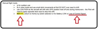

The Flight logs indicate the aircraft was in "Manual Mode". That is why I asked about Manual Mode in Post #11. It will NOT respond to RTL when in manual mode. Loss of RC when in manual mode results in the craft simply continuing to drift.
From the enhanced User's Manual:
You also HAVE to open the advanced menu, in order to put it in manual mode. You simply can't do that by accident.
Yeah. I know. That's why I'm asking if you put it in manual mode. If you did it, then it is normal behavior (given the circumstances). If you did NOT place it in manual mode, it may be a clue related to controller performance.
