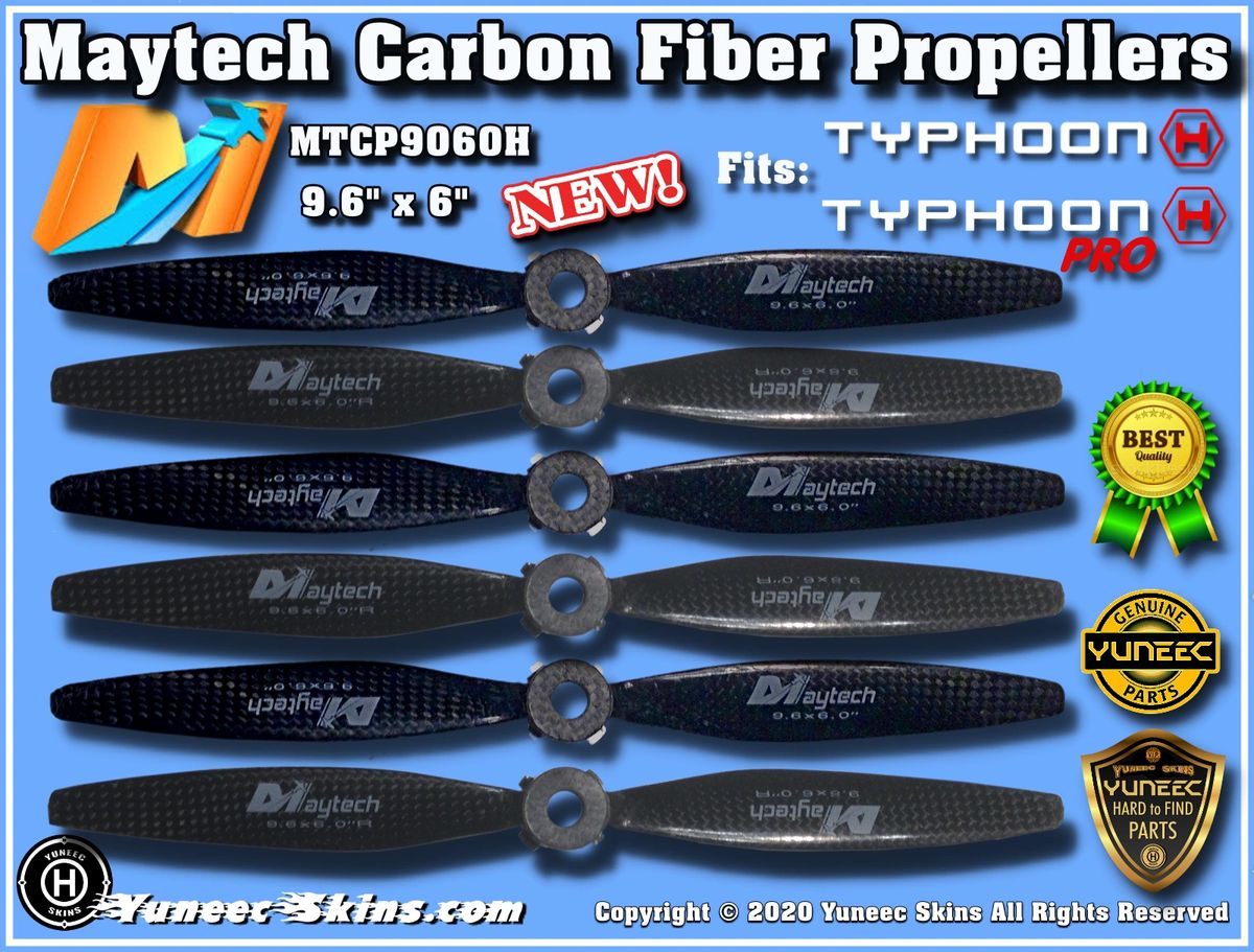

I have 1-Set of Maytech Carbon Fiber Props left in stock, that is probably the Only Alternative available.
The Air is pretty thin at 10,000 feet, the Carbon Fiber Props won't flatten out like the OEM Props, it may Help a little.
Link to Carbon Fiber Props,
Thanks for the information.?
