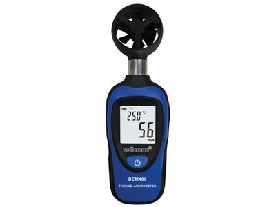

Remember that winds on a higher level can be far more and hefty as this mini-drone can handle and is designed for. That weak little thing can't return to mama because the wind is so strong.. Don't forget to bring your anemometer! ;)
