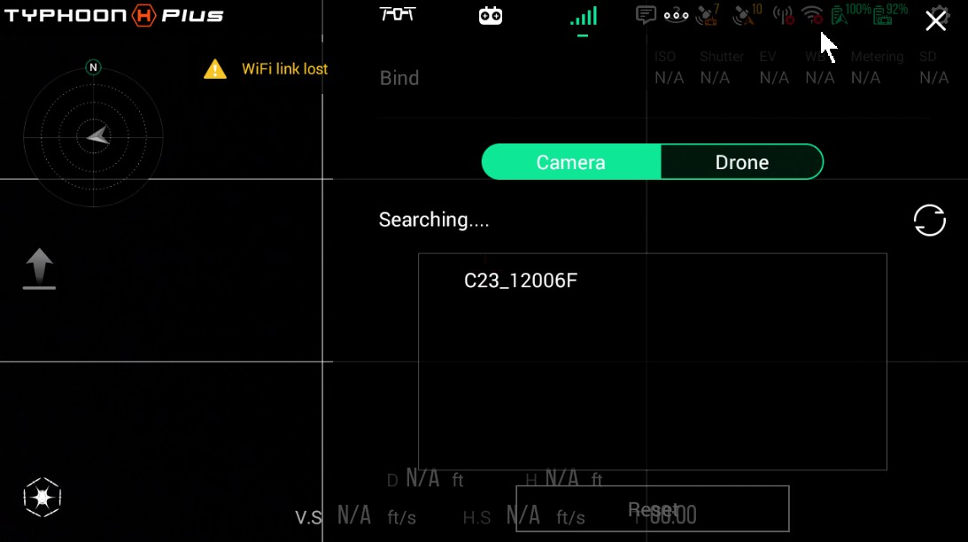

1) Slave Setup: Manually disconnect the 5.8WiFi link. Tap the Settings icon then tap the WiFi icon. Let the ST16S search for the camera, when it appears in the window tap it to connect if it isn't already connected. Now tap Reset to force the disconnect.

After you press Reset a notice will appear indicating the WiFi link is lost and the 5.8gHz icon will now be X-ed out.

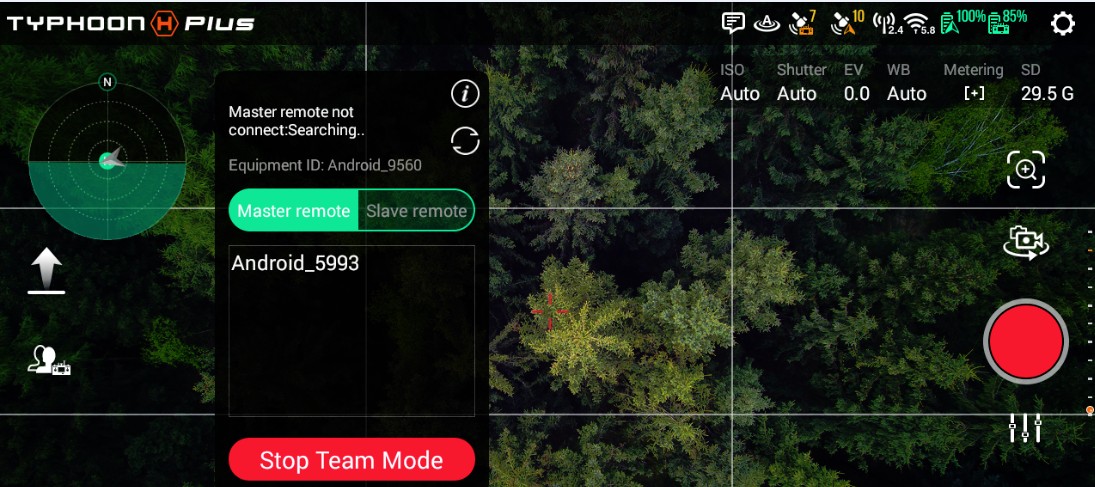

2) Master Setup: Tap the Task Icon and then tap the Team Mode Icon. A window will appear and the Master will search for a Slave.

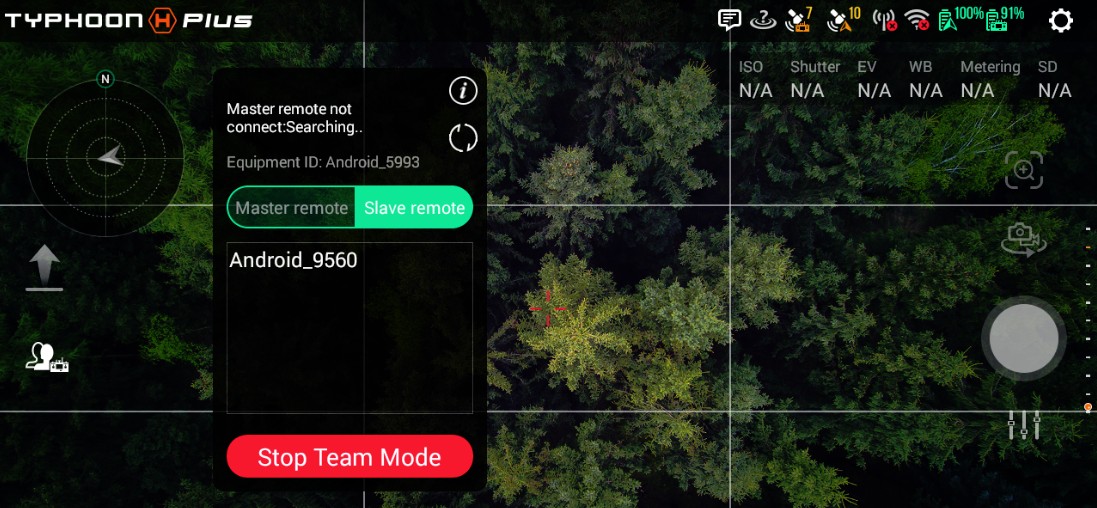

3) Slave: Tap the Task icon, then the Team Mode Icon. Select slave and wait for the Master ID to appear in the window. When both IDs are shown on both controllers tap on the Master ID -in my case Android_9560, this will send a Connect Request to the Master.
