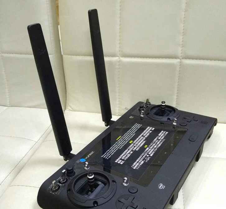

Those are both 2.4 GHz antennas. The video antenna is 5.8 GHz LHCP (left hand circular polarized). You would not want to use a stick antenna for video. It should be a flat panel.
2.4 last signal to lose anyway, I use 4hawks anyway.
