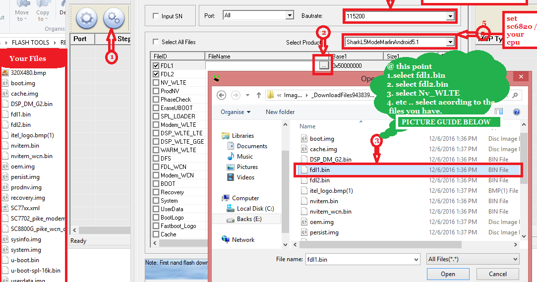

Downloaded the SPD Tool and the coolpix pac file and installed as
@Momchil suggested.
Importantst step was to use a OTG Cable and a USB A to A connector and connect the ST10+ to the PC.
Connect the OTG between pc and ST10+ but without battery attached.
Insert a fresh formatted SD Card into the Slot with update.zip from a usable yuneec update on it in root directory.
Started SPD Tool and select the .pac file and klick on the play button in spd tool.
