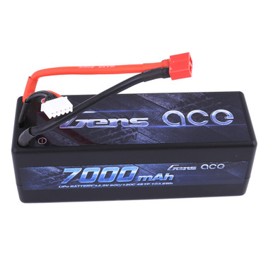

I'm working on a alternative battery for our H's.
Wish me luck, I just ordered one of these, hoping it will fit our battery bay.
If it does, more details later.
Hint:
