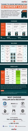

Another hint for maximum video range and quality: USE A VERY FAST SD CARD in the CGO3 camera!!! The card MUST be minimum "U3" and "C10". The circuitry in the video camera literally CHOKES if you use a slower SD card. The system lag becomes 5 to 7 seconds. The downlink picture is terribly broken up. Gimbal stabilization is crappy. Even the 2.4 GHz link is negatively impacted. I'd accidentally popped in an SD card with a lower speed class. After troubleshooting EVERYTHING and not solving the problem, I changed out the last possible culprit. The results were amazing! I had my good old Q500 back.
Here's an infographic of memory cards:
Danny J
