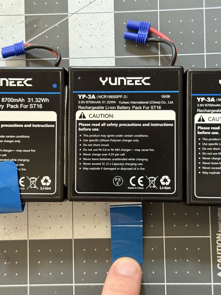

I have these in stock in my shop, new with >5 cycles in each battery:
ST10/12 ($24.99):
ST16/ST16+ (44.99):
