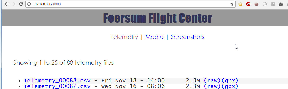

Here's how to get your telemetry files:
1. Start Flight Center and make sure the text at the bottom of the screen is saying 'Online' in green.
2. If it says offline, tap it and connect to your home WiFi
3. At the bottom of the screen it will give you a URL. Type that into your browser on your home PC on the same WiFi network.
4. You should get a screen looking a lot like this:
5. If the URL doesn't work on your PC, tap the 'Online' message on the ST-16 and check you are connected to your home WiFi network (not the Typhoon camera)
6. Click on the (gpx) link on the right of each telemetry entry to get the GPX file for the flight.
You can download the videos and images from your flight by tapping 'Media' at the top - note they're just the 720p FPV video you see on the ST-16 when you're flying - not the high resolution pictures on the camera.
You can use the .csv files with Dashware to synchronize with the high resolution video from the camera.

Oh sweet thank you TUNA for your help, for some reason I've been on that screen often on my phone & laptop but i just never looked around enough to notice the right hand side where it says the gpx link but now that I know that Ill be using it. Im fine with the 720p videos because most the time DashWare is such a pain to get close to synced up but it seems that most every telemetry and video when viewing on the Flight Center app just line up like magic. TUNA if Im not mistaken aren't you the person behind the development of Flight Center? If so props to you its a great app. & because of your app it proves easily that our H's are more then capable of showing us exactly what Heading is of the H. Because if Yuneec releases a firmware update that will add the ability to show us the H's heading on our ST16's then that is the Only last item that is need for us to be able to do mapping in screw like zig zag flights accross wherever we want to map. Thank You Much Tom C
