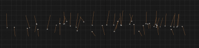

The altitude measurement is faulty.
On the picture you can see how faulty the height measurement is.
The white "dot" shows the position corrected by the software and the beginning of the orange one shows the altitude from the EXIF information.
I flew at the same altitude, but in the Exif data are differences of 3-6 meters.
Is this another software bug, or can it be calibrated or fixed?

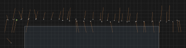

One more example:

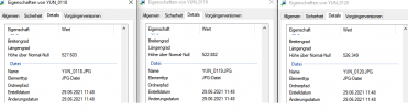

My problem before was that the decimal point was in the wrong place.
Now it is in the right place, but the height is not consistent and not correct in relation to the real height.
Here you can see pictures taken from left to right with a distance of 3 meters at the same height.
This is currently the case in all images through .... I preferred the wrong decimal point, because at least I was able to get accurate results without having to spend a lot of time reworking.
