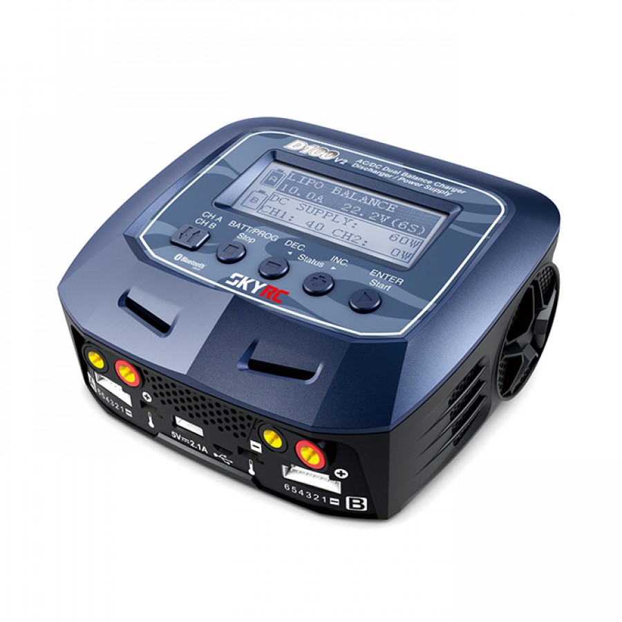

That's a little too expensive for me. Is there something you might recommend with fewer features?
You can move on the two bay model, the D100v2.
Don't forget you need adapter cables...like this:
There are several manufacturers that make usable chargers. What you want to find is that it must be capable of charging LiHV cells, has storage voltage function, measure individual cell voltages and internal resistance. For your batteries you want a charger that will supply 75W to 100W (per port if it is a multiport charger) so you can charge at a 1C rate when necessary (best to charge at .5C to .75C to extend battery life.
