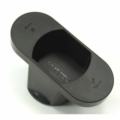

Sourced the carbon fiber tubes on Amazon, only need to replace the "feet", T at bottom intact, top of vertical member also intact. Two good actuators they both work fine when installed. One has a broken seat - the piece that attaches the actuator to the leg. Anyone have one of those? Listed on the German and French sites, but if anyone here has one from a wreck...

**** i dont get it the H puller is $12.49, and the H+/520 is $5.99 ?
Sounds like a challenge to the 3d printer specialist guys.
If I can get my hands on one of it - next order - I will give it a try. Since a friend has the one for the H+ I would go for a dual purpose tool. But I have some other projects running (Typhoon Thunderbird Mod, RasPi multi-spectral cam, fixed wing UAV...) so it might take a while ?... oh, yes, and there's also a job to earn money to afford all the before-mentioned ?
