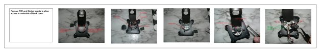

...... The e90x is actually more simple to get access to these boards than the c23 or e90. On them 2 cameras u need to remove the mount on top to get access to 2 screws that hold the plastic cover on the back of the arm, in this camera even though there is treaded holes for them screws there is none present at least in all my units , it likely yuneec used the same arms as the older models but felt it not necessary to add these screws .
The screws are missing on most C23 and E90 cameras I have seen also. But for those that have them, Yuneec provided an easy access. There is a hole in the lower half of the C23/E90 mount that can be aligned over either screw. The top half of the mount pushes aside to allow room for a screwdriver to reach through and remove the screws.
Then throw them away. No need to repeat the error of whoever installed them in the first place.
Well that’s clever, I wish I knew this before 😂. I love the fact u then throw them away 🤣. That’s the one thing with these repairs , u always find a few extra screws after reassembly and just hope for the best 😃
