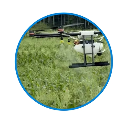

Not a huge need in MidWest, but have you looked / read about the larger scale drones used to spray... I read several USA vineyards were beginning to use them, very popular in Asian Ag. I understand they require additional certifications to fly based on applying chemicals.
Found a few links on the Ag sprayer... one example.
Has a new 1S version released too.
Even if not in the plans... interesting read where Ag drones are developing... expensive, but also reasonable compared to just a few years ago or to cost of using conventional means if not wanting to disturb crop ground.
I do think it is very cool to see drones developing but we are too large scale to implement something like this. Generally 100 gallons of mixed chemical will spray 10 acres of a planted vineyard for herbicide and that is just x2 16" strips under the drip hose, the rest will be disc in or mowed. For insecticide's we must spray the entire canopy which means a much higher gallon per min. I am not sure if they are using sensors to detect problem areas and only spraying those but this would not make sense to me. If a plant is infested with something like mites it will not show signs of damage for a certain amount of time so if you are only spraying what is showing damage it will be a constant game of catch up. I believe you would also need something close to the license a crop duster would need.
