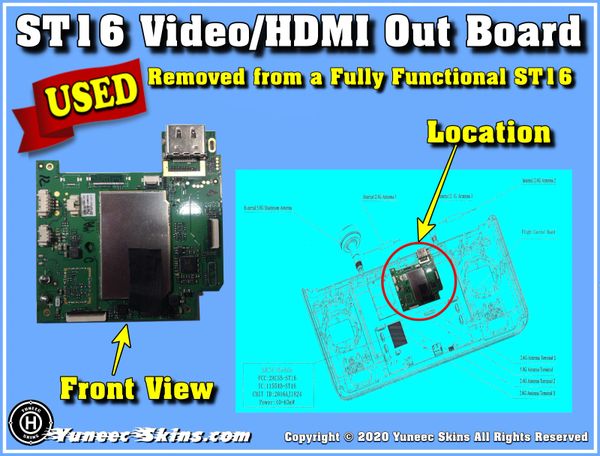

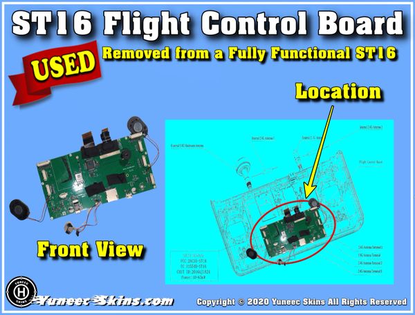

The problem is one of three boards in the controller. I believe the most common one with a failure is the 5.8ghz wifi module, but it can be others, and it can be more than one.
This problem can get expensive to fix if you are buying parts just to see if that part fixes the issue. Parts swapping works best if you have some spares. IF you don't have access to a working controller for parts swapping, it might be less expensive to send the controller to a repair shop or just replace it.

Is there a way that I can test these boards myself to see which one or ones are bad ? I'd like to take a look in there to see what's what.
