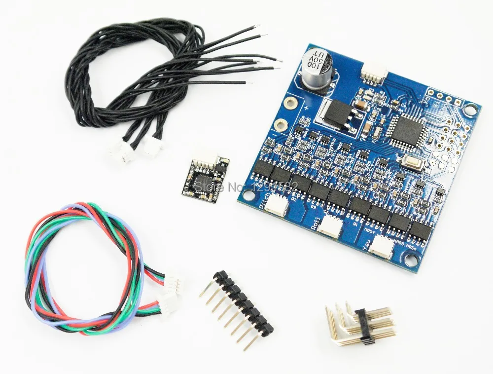

Do you mean the CGo3 Gimbal Board as pictured below? If so, it will not work by simply installing a new one or even one from a working camera. The board has to be calibrated to the specific camera, and the calibration program for that was never released to the general public.

Thanks for your reply, if the new controller won't start there is no point in looking. Be healthy!

Power feed to the camera from the aircraft is through a 1.5A K fuse.
This part of the controller that powers the camera itself works, but the other one does not, there are no lights on the controller itself, 3 integrated circuits together with stm 32 are hot, so I want to power the camera separately and put a new controller
You can power the camera alone. Trace the wires.
You can't control the gimbal with third party controller I guess.
