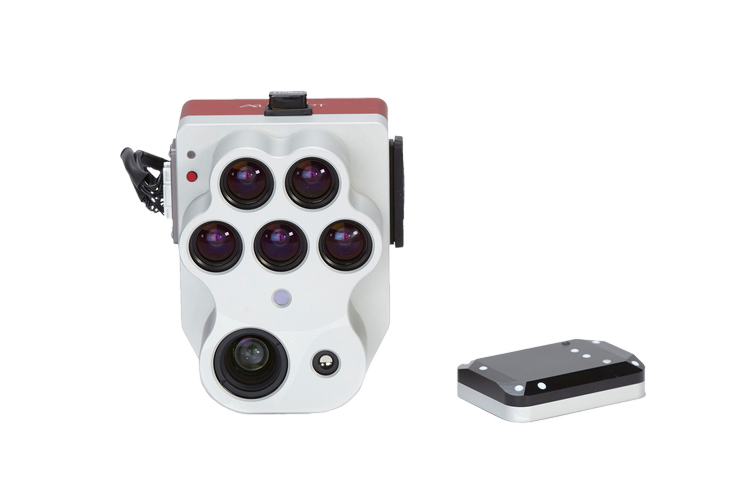

The other brands / models Sentera & Rededge also have light sensor component too.
The only negative of the Sequoia compared to the higher priced Sentera & Rededge is the built in RGP sensor. It apparently it's RGB is on the lower end of the quality.
