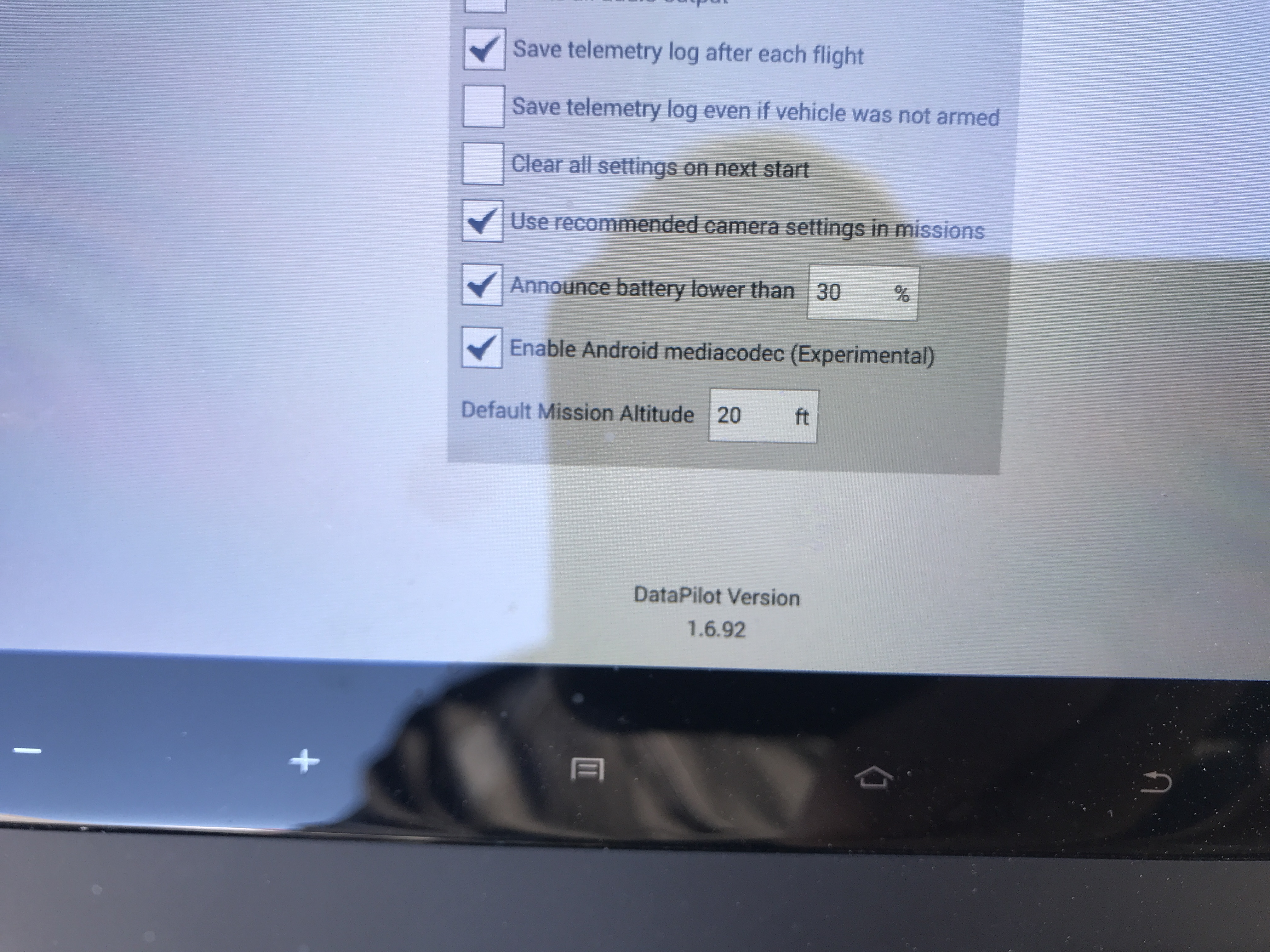

You won't notice any closer view with the 3,77 lens. It's there but in such small amount it's not worth mentioning. The two images below were shot with PixAero 3.77 and stock lens cameras from a table last winter just after receiving the PixAero.

There is definite variation in how well the stock lens is focused. In my case, the original camera with my primary H became bricked with a particularly messy firmware update in Oct 2017... many people on this board had issues with that firmware revision. But Yuneec did do the standup response and cross-shipped me a new OEM camera. That replacement camera was very well focused, and IMO probably gave as sharp an image as is possible from the stock CGO3+ lens.
About a month later I purchased a 2nd H from a member here who was dissatisfied with his bird. When I received this second Typhoon, I did some comparisons of both video and photos between the two Hs. I was at a minimum, going to replace one of the CGO3+ stock cameras with the Peau 8.25, as that was the primary reason for my purchase. (As it ended up I replaced both camera lenses... #1 with the PixAero 3.77 and #2 with the Peau 8.25)
This second camera was not nearly as well focused as my factory replaced camera. It was not of much concern to me at the time, as I was never intending to use that 2nd camera lens. Nonetheless it was surprising to see such a degree of variation between the two.
Primary OEM Yuneec Lens Test
Secondary OEM Yuneec Lens Test
