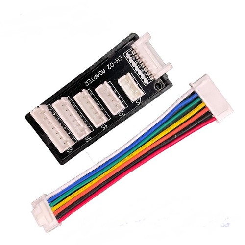

I wondered if you are looking for any of these parts that can be combined to use a standard aftermarket charger to charge the ProAction battery:
