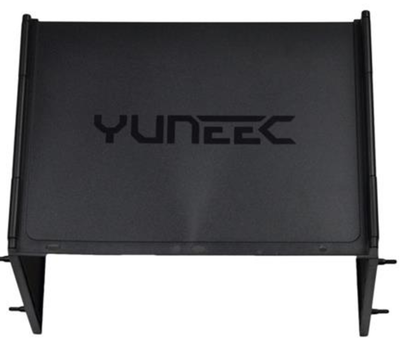

I bought an ST-16 sunshade from Vertigo Drones. In no way does it fit the controller. It flops all over the place. I sent pictures back to the supplier & they suggested I buy a Hoodman sunshade. Does anyone have a Hoodman, does it fit & is it worth $60? Thanks ahead for any comments.

Flops all over? Hmm... Not to doubt, but did you install it correctly? There are 4 studs sticking out of the st-16. Each one has 2 holes. A big hole for the neck strap & a tiny one below it for the pegs on the sun shield. Admittedly, the first time I put mine on I was like, "what the bump?" Come to find out, it's better to wear my glasses as I didn't even see the tiny holes.

You are correct---I did not install the sunshade correctly. Now I've got to wonder if it would have actually worked. Thanks for enlightening me! Vic

Happened to me the first time too....didn't realize there were 2 holes...and I was pretty disappointed that the shade flopped around and I couldn't use the neck strap at the same time....then I found the smaller holes....

Make sure you have in the correct holes on the controller.

Yes the correct holes must be utilized.
