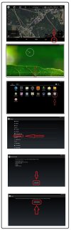

I know of no home method to physically clean and restore beyond the factory reset you performed prior to the last update. That is not an actual reset. It is simply a clean-out of all user installed settings and apps. The only method I know of to physically clean and restore is the boot load process to install a new image. The boot load process requires an image we do not have, but some repair shops may. It also requires the proper software, the knowledge to set up and use it, and possibly a computer that is compatible with it.
"What does ‘return to factory settings’ mean?"
I can't see that exact phrase in the thread. Although it could refer to a Boot load, it most often is used to refer to the factory reset of the controller, which I think you performed prior to the last update effort. Did you run through this sequence prior to doing the update?
