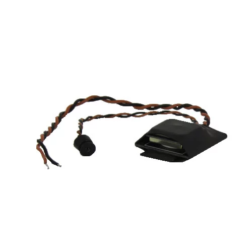

Here is a very neat little device made by Skynnov. It is fitted inside the top shell of the H series drones and connected to a 5V power supply from the drone. They also have two other models that carry their own small battery and can be fitted to multiple drones in the (same weight group). iIt has a power on indicator led and only waes 12g

Signal Drone SD20L
SD20L: L for Light or Light
In this SD20L version, it is lightened (12 g), coated in a heat-shrinkable sleeve in
order to be integrated directly inside the drone, for example by the manufacturer or the specialist dealer. The two wires of about 15 cm are then connected to the 5V power supply of the drone. In this case, it is fixed and used for a single drone. A simple hole in the shell with the addition of the wire of about 10 cm with the remote LED, through a grommet, makes it possible to check the correct functioning of the system when the drone is switched on;

For sure doesn't. This device is dedicated to watching what is doing your employee with your investment. Nothing more. Transmission is over 4G (LTE) with a SIM card from some mobile operator. On the previous page was a picture with expectations about minimum telemetry from the copter to the ground control.
I think the best is to force CAA's to agree that MAVlink messages translating via ZigBee protocol and enough consistent for this purpose. Any ZigBee transmitter IC has a unique ID, so there is not necessary to have more IDs if the target is to clearly know who is in the sky.
No, if you want to smash neighbours business with hard investment in strange devices, let you.
All the public still waiting for the explanation of how do you wire this device, and where is an antenna to a dedicated channel, for which you forget.
