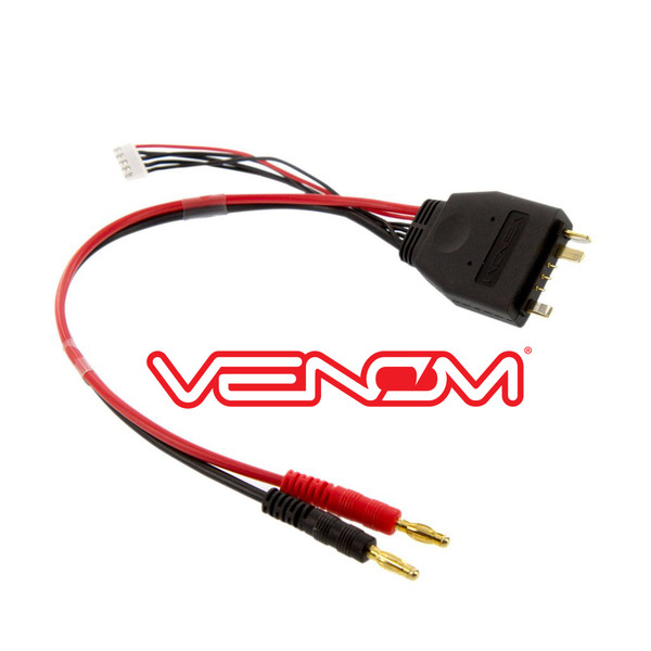

Found the D100v2 online but I don't see power cords or battery adapters. What else will I need to use the D100 on my Typhoon H batteries?
You can also convert the OEM charger to make it compatible with the D100v2.
This modification allows the charging block to be used normally if doing a full balance charge either with the power converter or the 12V car adapter cable. Otherwise use the added banana connectors with 12 gauge wire along with the 5 wire plug for balance charging using the D100v2 or other like charger.
