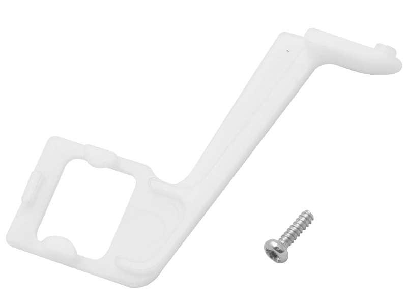

I would like to ask, were is the best place for the compass in the Q500 Rakon Heli body ?
Most place it as far forward in the nose as possible. Be sure to twist the wire harness to reduce magnetic interference.
It is desirable to have the compass and the GPS units as far as practical from any other electronics on the aircraft. The compass also needs to be firmly mounted so it cannot change its position once calibration is done.
The Rakon frame kit comes with a delrin compass bracket to mount the compass board under the rear of the frame away from the camera, gimbal, and flight control board. It can be seen in the second to the last picture of post #5.

Morning, I had to dig for my answer of where to mount the compass, the kit has it under the rear and on the RH side, you can see it hanging down under the air frame, white, looks like a little flag.
In pic 2 of the linked thread, gotta scroll down to the post with pics in it, then click on the pic for an enlargement.
The instructions didn't label it as the compass mount, only what screw to hold it in.
It' seems to be in a precarious place but you'er going to have to try pretty hard to damage it in flight.

Found a link to the compass bracket,
And another pic of the location, you see it hanging down on the right hand side.
Click on the pics to enlarge.
